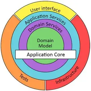

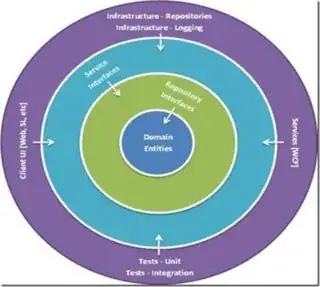

The two diagrams below seem to be the most common ones that appear all over the web when I'm Googling info on onion architecture:
enter image description here enter image description here Enlarged images: diagram 1 and diagram 2
If I'm not mistaken, anything below the outer ring is considered the Core.
In Diagram #1 the most outer of the Core (blue ring) contains service interfaces, and it shows that the purple outer ring has the logging, services, etc. So does that mean the outer purple ring contains the service layer and business logic?
In Diagram #2 it shows Application and Domain Services as a part of the Application Core (not just interfaces and the domain model).
I feel that these two diagrams seem to define Onion Architecture completely different, but yet they seem to be the two primarily referenced. Or am I reading this wrong?
Maybe the end-result is no different, and it's just a matter of how I'm viewing the project layout in my head, but I've been trying to think of the service layer as a part of the Infrastructure on the outer ring. Is that a wrong way to think of it?

Business logic is actually split into two kinds in either one.
Data                                | Domain Entities      | Domain Model
Data Business Logic                 | Repository Interface | Domain Service
Software Environment Business Logic | Service Interface    | Application Service
Data Business Logic is the purest, most abstract, business logic. Here things like your age are derived from your birthdate and a timestamp. Here, only things that would make sense to a domain expert are allowed to exist.
Software Environment Business Logic is allowed to be aware of more than the domain. It may acknowledge the existence of the software and do some housekeeping for that. Such as express your age as a number, in a particular language, as a % of a progress bar, or as a cartoon picture with a long beard.
Onion Architecture isn't the only one to split up business rules like this. You see the same thing in Clean Architecture1:

Business logic is the inner circle in both pictures (domain model/domain entities). This if where the meaningful processing takes place, the rest is just plumbing to make the system work.
The left picture assumes application of the repository pattern, hence the differing terminology (repository interface vs domain service). Basically the pictures are identical.
