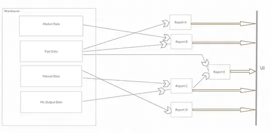

Is there a cleaner/ better readable way to maintain and iterate many-many mapping rather than multiple if conditions ? (One way would be to store the mapping of ReportType -> DataSet Req. in the database)
For e.g if there's an application which depending upon 'reports selected', generates reports using data from required database tables. Something like this: enter image description here
Now since the data to be fetched in these tables is huge and shared for multiple reports, we came with a not so good looking approach to optimize getData function using if() conditions like this :

  • @LoztInSpace I consent on that but I'm doing this since the DW is managed by separate team and due to auth limitations we are not allowed to run queries directly. – pxm Jul 05 '18 at 15:36
  • Why `ReportC` doesn't need `pastData` ? (so far I understand it should because of inheriting `ReportE`) – Spotted Jul 10 '18 at 12:19
Like this, you're attempting to write conditions based on what data you'll need, when you should be writing it in terms of the data required for each individual report.

When mapping professional information you should try to make it as clear and readable as possible.
DAO-Types should be a central entity:
public enum StoredDataType {
    MARKET_DATA  ("marketData",   "MarketData"),
    PAST_DATA    ("pastData",     "PastData"),
    MANUAL_DATA  ("manualData",   "ManualData"),
    MLOUTPUT_DATA("mlOutputData", "MLOutputData");
    public Reports(String entry, String dao)
Reports should clearly define required data:
public enum Report {
    REPORT_A(PAST_DATA),
    REPORT_B(MARKET_DATA, PAST_DATA),
    REPORT_C(MANUAL_DATA, MLOUTPUT_DATA),
    REPORT_D(MANUAL_DATA),
    REPORT_E(MANUAL_DATA, MLOUTPUT_DATA, PAST_DATA);
    public Report(StoredDataTaype... requiredData)
And your logic can easily create the required Entries:
Arrays.stream(StoredDataType.values())
    .filter(d -> requiredReports.stream().anyMatch(r -> r.requires(d)))
    .forEach(d -> dataMap.add(newEntry(d.name, d.daoName)));
