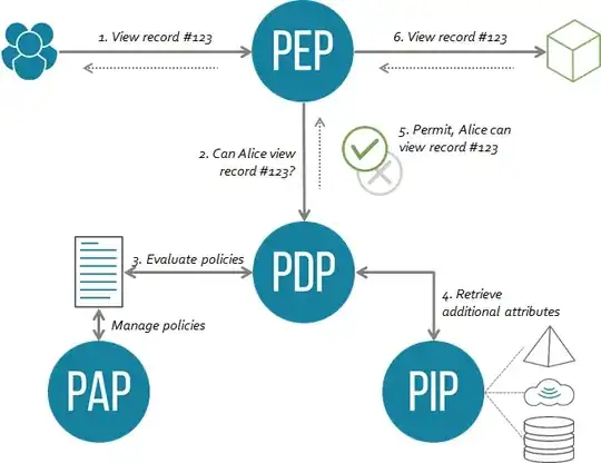

ABAC also comes with an architecture to define how the policies will get evaluated and enforced.
ABAC diagram
The architecture contains the following components:
  • the Policy Enforcement Point (PEP): this is the component that secures the API / application you want to protect. The PEP intercepts the flow, analyzes it, and send an authorization request to the PDP (see below). It then receives a decision (Permit/Deny) which it enforces.
  • the Policy Decision Point (PDP) receives an authorization request (e.g. can Alice view record #123?) and evaluates it against the set of policies it has been configured with. It eventually reaches a decision which it sends back to the PEP. During the evaluation process, the PDP may need additional metadata e.g. a user's job title. To that effect, it can turn to policy information points (PIP)
  • the Policy Information Point (PIP) is the interface between the PDP and underlying data sources e.g. an LDAP, a database, a REST service which contain metadata about users, resources, or other. You can use PIPs to retrieve information the PDP may need at runtime e.g. a risk score, a record’s location, or other.
XACML can be implemented for any kind of resource, including databases. For a database, however, you will need a proxy to intercept these requests and act as a translator. By doing this, you can implement filtering and masking as granular as you would like.
