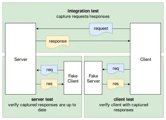

When testing the interface between two parts, the easiest way is to test those parts together, i.e. perform integration tests. If you want to test each part in isolation (i.e., perform component/unit tests) then your tests will contain a duplicate description of this interface, which may diverge from the real interface.
One possible solution is to structure these tests so that these tests can be verified against the real interface. E.g. by recording real interactions, and replaying them during your tests. When you capture an interaction for a web API, you have a HTTP request and response. This is great, because it's easy to replay those with a fake server or client.
  • Test the client against a fake server. This server verifies that the client's request match the recorded request, and responds with the recorded response.
  • Also, test these responses against the real server. Run the recorded requests against the real server, and verify that the real response matches the recorded response.
If these tests fail, the interface has changed unexpectedly. You must then fix the client or server, and re-record the failing interactions.
Diagram of the various tests
The advantage of using recorded interactions over pure integration tests is that the recordings can be replayed faster, and can be easier to debug. The suite of recordings is shared between the server and client, but both can be developed independently – you do not need to run the client tests when changing the server, as long as the recordings still match.
If this is supposed to work well, you will have to set up some automation for capturing the interactions. Ideally, you can run your client test suite in a recording mode that saves the response when run against the real backend. This doesn't necessarily have to be supported by your test framework, as this recording can be done in a proxy HTTP server. You will also have to strip out irrelevant details such as timestamps, so don't save the raw requests. Often, deleting various headers and filtering the body through some regexes is all that's needed.
