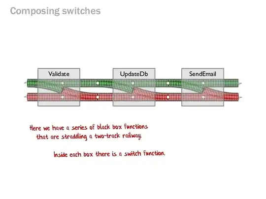

    Wouldn't it be more appropriate if the red track was **below** the boxes, thus not running through them? – Flater Jun 04 '18 at 09:33
    Logically, you are correct. However, each box in this particular diagram represents a monadic bind operation. bind includes (perhaps creates!) the red track. I recommend watching the full presentation. It is interesting and Scott is a great speaker. – Gusdor Jun 04 '18 at 10:27

then you do have a problem and exceptions would be the better choice. Compare Rail's save vs save!.
