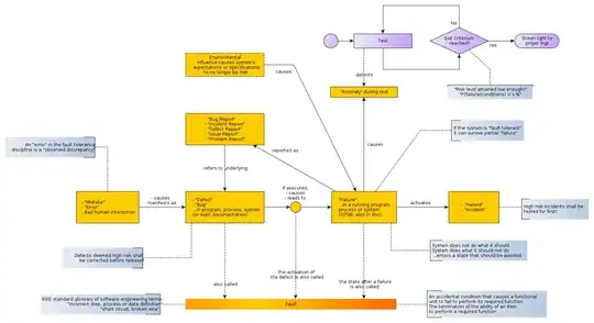

Here is one I did earlier for my employer Q-LEAP based on the ISTQB vocabulary and I also checked the IEEE vocabulary. Enjoy.
Bug and Defect? The same even though one can have endless discussion about this. We have really other things to worry about, life is complicated enough already, etc.
