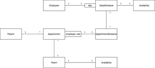

I recently started reading Evan's book about DDD, and I decided to try and apply some of the principles from that book on a bounded context of a project I've been working on.
The context of interest deals with appointment and appointment scheduling. I will present some of the business requirements, as well as the current model.
We have Employees, Appointments and Rooms. An appointment can have at most 1 employee per role, for example 1 counselor, 1 doctor. These employees all start and finish their part of the appointment at a different time. For example, a counselor can be present from x1 till y1, and a doctor can be present from x2 till y2 (these can overlap, or be disjointed). The appointment is considered to start at the earliest x, and end at the latest y. An appointment can also have only 1 patient. An appointment must take place in a room. Employees cannot have overlapping appointments (regarding to their own start and finish times). An appointment cannot take place in a room if that room is occupied for a different appointment.
This is the model I came up with:
initial model
In addition to the previous invariants, these business rules must be upheld: A patient can have only 1 scheduled appointment at a given time (assume there is a status attribute in Appointment).
The model should support the following use-cases:
  • Scheduling an appointment.
  • Updating an appointment schedule's start/end time
  • Assigning a different employee to an appointment
  • Adding/removing appointment schedules from an appointment
I have trouble defining the aggregates, their roots and boundaries. From the given constraints, I think it is pretty obvious that the DailySchedule aggregate needs to encompass the Availability and AppointmentSchedule value objects. However, Appointment also needs to encompass AppointmentSchedule in order to maintain the invariant that there should be only 1 employee role per appointment. Furthermore, Room and Patient both need to encompass Appointment in order to maintain their invariants.
Supposing that Patient's invariant can be modeled as a business rule/policy object, that still leaves DailySchedule and Appointment sharing a reference to a value object, without going through its aggregate root.
It seems to me that this model does not allow for clearly defined aggregate boundaries. I was considering exposing SERVICES for each of the use-cases, that would span between the aggregate boundaries and maintaining the invariants from there. I am interested to know if there is any other, possibly more elegant/simple solution to this problem.

  • _An appointment can have at most 1 employee per role, for example 1 counselor, 1 doctor._ Does this mean there can be more employees with different roles present in a single appointment? – Andy Apr 27 '18 at 12:37
  • @DavidPacker yes, however 1 employee cannot be both a counselor and a doctor on the same appointment (these will be separate classes anyway, so I did not include this constraint in the description) – Stefan Rendevski Apr 27 '18 at 12:55
  • @StefanRendevski what is the expected load in terms of concurrent write access to patient, employee and room schedules? – guillaume31 Apr 30 '18 at 13:23
  • @guillaume31 This is expected to be minimal – Stefan Rendevski Apr 30 '18 at 14:04
  • I wonder if a central `AppointmentSchedule` aggregate containing all appointment invariants could do the job. Is `Availability` an external factor or can it be entirely derived from usage of a specific room in Appointments? – guillaume31 Apr 30 '18 at 14:37
  • @guillaume31 It is a value object that can be derived based on scheduled appointments in a room. I realize now that the initial model is not detailed enough, because a Room can have a DailySchedule, just like an employee would have. It could be renamed to TimeTable, and a TimeTable could have many TimeTableEntries, instead of being directly linked to AppointmentSchedules. Please note that a Room is occupied for the entirety of the Appointment, meaning for all the AppointmentSchedules an Appointment might have. – Stefan Rendevski Apr 30 '18 at 15:39
  • You will spare yourself some trouble if you distinguish between data that can be calculated (daily schedule, availability) and the core data that will be modified. i.e., applying CQRS. – guillaume31 Apr 30 '18 at 15:50
  • @guillaume31 i will have to read into CQRS, as I am not familiar with it. Thank you for the pointers – Stefan Rendevski May 02 '18 at 09:20
A good starting point for you would be Yves Reynhout's Evolving a Model, where he describes the modeling of appointment scheduling for healthcare.
You might also want to review Greg Young's discussion of warehouse systems. The summary is this: if you have a reasonable way to detect and report a scheduling conflict in your data, you may not necessarily need to prevent violations from occurring.
One insight that helped me to grasp this is that the order that messages arrive is not a guarantee of correctness. Udi Dahan, in Race Conditions Don't Exist, observes
A microsecond difference in timing shouldn’t make a difference to core business behaviors.
Here's a message saying that Dr. Frankenstein should be in room A from 10:00 until 11:00; here's another message saying that she should be in room B from 10:30 until 11:30. It's clear that the two messages are not consistent, but we don't know which is right - in particular, there might already be a message coming that cancels the "wrong" appointment, we just haven't seen it yet.
In many cases, what we are really looking for is something like the solutions Greg Young describes in Stop Over Engineering; first escalate problems to the human beings, then work on identifying problems that are simple enough that solutions can be automated.
Systems that overly constrain to prevent conflicts often inflict disappointing experiences on the users. There was a data entry error, but before we can enter the correct data for this appointment, the system interrupts that tasks and insists that the error be corrected. Furthermore, correcting that error may be complicated.
If you keep in mind that the role of a scheduling system is to identify and resolve conflicts, rather than prevent them, you may find that you have a lot more freedom in how you design your aggregates.

  • +1 for the links, they were really helpful. Handling inconsistencies is somewhat out of my control, however, but the presented ideas are interesting all the same – Stefan Rendevski Apr 30 '18 at 14:11
  • I have accepted your answer, because i investigated deeper into the resources you provided. I realized I now have a different that needs answering, but as it is not exactly related to this, I will have to post a new one. – Stefan Rendevski May 13 '18 at 17:53
