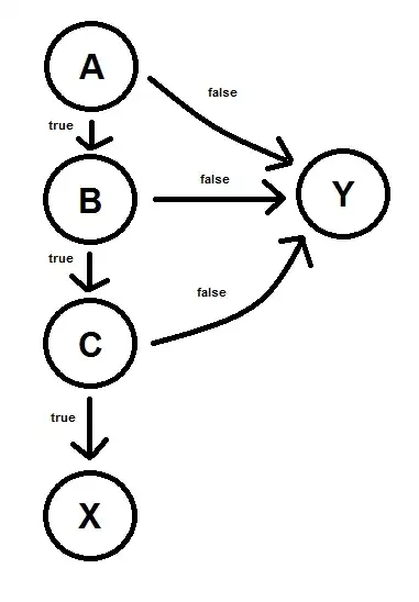

But I believe this is not right (it implies path is only "visible" branches), because even cyclomatic complexity is increased by one for each logical operator in a decision, stating that a new decision node is created in the program control flow chart, creating immediate paths that needs to be exercised - in short-circuiting languages. Therefore: if(A && B && C) have two paths from the traditional perspective (branches), but precisely there is more than that if the language allow short circuiting. Thus, I believe the statement quoted is not correct. Even for a single decision, they are equally strong. In the context of a whole method, path coverage is obviously stronger as with every decision the total count doubles.
Am I missing something or is my reasoning correct?
John V
  • 4,898
  • 47
  • 73
So I understand what you are saying to mean that this:
if(A && B && C) { ... }
Has this graph:
Which after drawing it out, I think indeed has to be correct. If A,B and C have no side effects e.g. if they are just primitive Boolean values, then I think you can get away with reduce them to the same graph as the non-short cut version:
if (A & B & C) { ... }
But if A, B, and C are functions, you really can't ignore the fact that B won't evaluate unless A is true and C won't evaluate if A and B are not true. So in order to get all paths, you can't just test the situation where A is false and the situation where A,B, and C are all true. You need to test where A is true and B is false, A and B are true and C is false as well so short-circuiting adds two paths.
