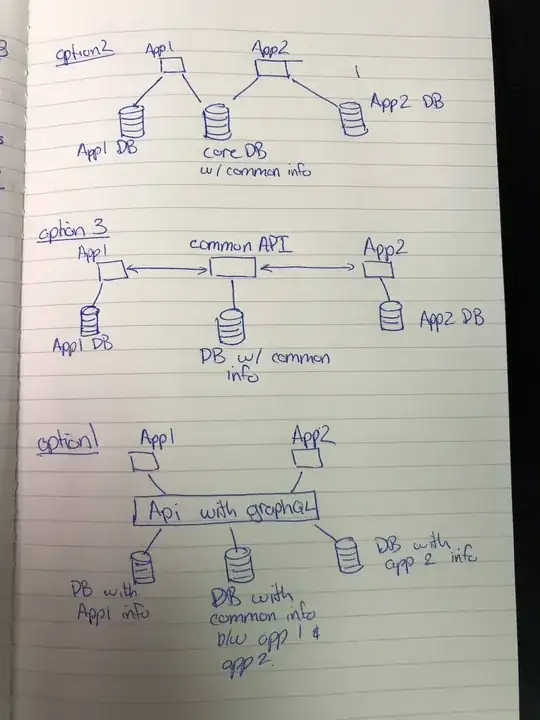

I'm trying to determine the best application and database architecture for a project I am working on.
The idea is that there will be multiple, separate applications that will all share a few tables like a User and an Employee table. Each Application will have a web portion (which may require an API, depending if server-side or client-side rendered) and an iOS portion ( which will require an API.) If I decide to go client-side rendering and use a something like Vue.js, React, or Ember. I may be able to consolidate the web and iOS APIs. (A side note: I am much more comfortable with server-side rendering and would have to learn a JS framework if deciding to go client side but will do so if that is the best option.)
I currently have 3 different approaches on how to implement this kind of system. All of them separate out the common tables inside a separate database that I will call COMMON_DB.
Different ways to implement the current system I am thinking of
(please excuse option 1 being last, I had to redraw it from the first page.)
--------------------Text Description of Options-------------------
Option 1:
Use an API along with GraphQL that would do all the communication with all the databases in the system. If there were 2 web applications, the API would have 3 databases connected, DB_APP_1, DB_APP_2, and DB_COMMON. The common database would contain tables that are duplicated/shared between the 2 applications. The applications(App1 and App2) would be Client or server side servers and would communicate with the DB API to get the certain information they require.
Option 2:
Each application connects to 2 different databases. App 1 would connect to DB_APP_1 and DB_COMMON, App 2 would connect to DB_APP_2 and DB_COMMON. App1 and App 2 would be server-side ( ether API for client-side or rendering client via server-side rendering)
Option 3:
Each application communicates with a Common API server. The Common API server has 1 database, which is the common tables of each application. Each App has their own database, which contains all the unique table for each application. Each Application would not have direct access to the common database like Option 2. Again, app 1 and app 2 would be server-side, ether APIs for a client-side rendering, or rendering the client server-side.
I am currently battling myself on which of these approaches would be the most beneficial and prevent roadblocks in the future. There will be some learning of new technologies which is to be expected.
Any thoughts and opinions would be greatly appreciated, please let me know if anything is unclear or you have any questions.

  • I think I would prefer to say away from having the common data in both dbs, as that would require additional work to keep them both up to date. They could all stay in 1 DB, but the idea is to have 5+ applications ( small but still requiring 10-15+ tables.) so the idea of splitting up the information is appealing. Im now considering if I should use multiple Schemas in 1 DB or multiple Databases that each having 1 schema. ( this also depends on if we decided to keep using MySql or use Postgres) – SegFaultDev Apr 23 '18 at 15:23
  • There are some informaiton missings : does your apps need to update things in the common API ? Specifically in the same transaction than updating their datas ? Is there the need to perform join between apps & common datas ? – Walfrat Apr 24 '18 at 07:52
  • Please let me know if you need more information. I believe there would be two ways to update/change the data in the common DB/Schema. Either there is a separate application that deals with managing the data and all the other applications cannot make changes to common db entities. Not sure if that is the best approach. Initially I was thinking that each application could make changes to the entities in the common db. Each application would call an update endpoint in the common api which would make the appropriate changes. Entities in the common table would be like, Users, Employees, etc. – SegFaultDev Apr 24 '18 at 16:40
  • there will be pivot/relationship tables inside each app that will reference entities in the common tables. As for joins, there may be a case for that? not one that I can think of right now. Would the need for a join change implementation? – SegFaultDev Apr 24 '18 at 16:41

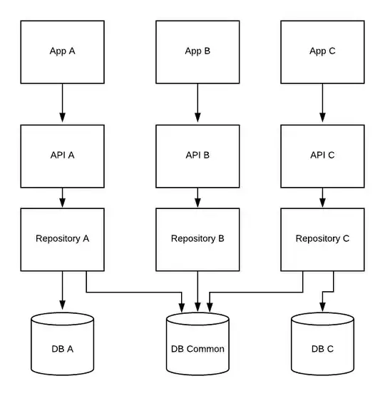

I like option 1. Your apps are then ignorant of their underlying persistence schema and the persistence management is done by the API (or layers below/within).
A common route would be your #1 option, with a repository pattern that has an interface like "get this", "get that", and the repository implementation deals with pulling the info from (and saving the info to) the correct database.
Alternatively, a separate API for each app, where each API has a repository somewhere below that does the same thing.
I would avoid the apps "talking to" the database directly as indicated in options 2 and 3.
Remember that (generally) each component should not generally be concerned with details of the services below it.
Generally speaking, the more segregated your services/layers are, the easier they tend to be to maintain over the long term, at the cost of a more complex initial setup. On the other hand, starting with a very simple architecture can be extremely difficult to deal with later on, so if there's any sort of expected longevity in the project, I'm much more apt to go with the architecture investment.
There's many variations on it (and if you're doing something like microservices you're in a much different realm), but here's a quick visual that gets the basic point across:
