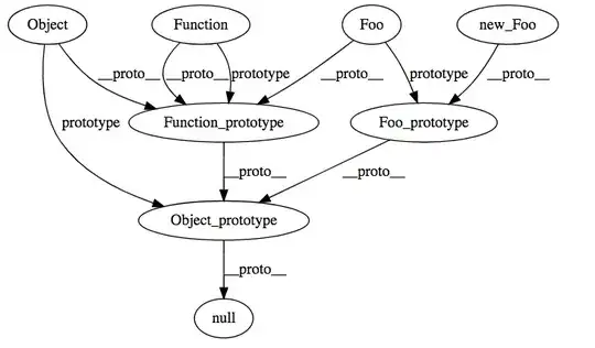

Let's suppose we make a function Foo.
  • The prototype of Foo is Function.prototype.
  • Foo.prototype is the Foo prototype object.
  • The prototype of Foo.prototype is Object.prototype.
Let's suppose we say new Foo()
  • The prototype of the new object is Foo.prototype
Make sure that makes sense. Let's draw it. Ovals are object instances. Edges are either __proto__ meaning "the prototype of", or prototype meaning "the prototype property of".
All the runtime has to do is create all those objects and assign their various properties accordingly. I'm sure you can see how that would be done.

The other extremely confusing thing is, if I console.log(Function.prototype) it prints a function but when I print console.log(Object.prototype) it prints an object. Why is Function.prototype a function when it was meant to be an object?
The function prototype is defined as a function which, when called, returns undefined. We already know that Function.prototype is the Function prototype, oddly enough. So therefore Function.prototype() is legal, and when you do it, you get undefined back. So it's a function.
The Object prototype does not have this property; it is not callable. It's just an object.
when you console.log(Function.prototype.constructor) it is again a function.
Function.prototype.constructor is just Function, obviously. And Function is a function.
Now how can you use something to create it self (Mind = blown).
You are over-thinking this. All that is required is that the runtime creates a bunch of objects when it starts up. Objects are just lookup tables that associate strings with objects. When the runtime starts up, all it has to do is create a few dozen blank objects, and then start assigning the prototype, __proto__, constructor, and so on properties of each object until they make the graph that they need to make.
It will be helpful if you take that diagram I gave you above and add constructor edges to it. You'll quickly see that this is a very simple object graph and that the runtime will have no problem creating it.
