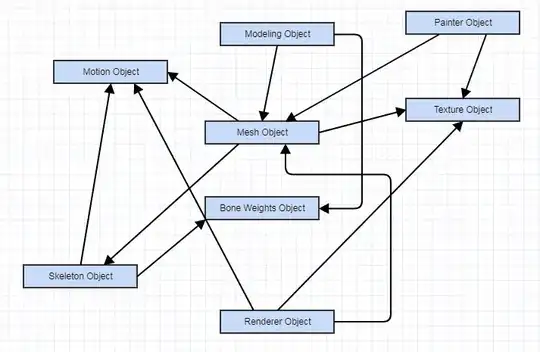

Components must access data of other components. E.g. the render component's draw method must access the transform component's position. This creates dependencies in code.

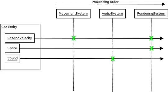

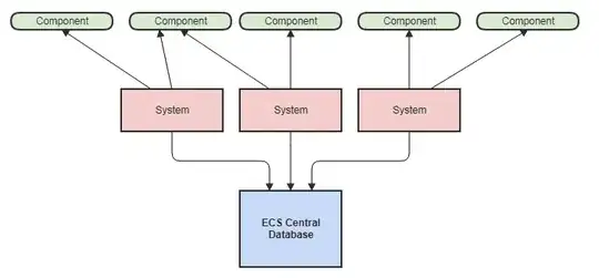

Don't underestimate the amount and complexity (not degree) of coupling/dependencies here. You could be looking at the difference between this (and this diagram is already ridiculously simplified to toy-like levels, and the real-world example would have interfaces in between to loosen the coupling):
... and this:
... or this:
