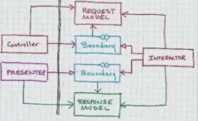

The controller passes you a request model, you build a response (after talking to some entities) and send that to a presenter. That shouldn't be a complex unit test because any one interactor shouldn't be doing anything more complex than that. I don't see any dependencies here that must be external.
You shouldn't only test the happy path. 80% of coding is dealing with things gracefully when they go wrong. But stick to fixing problems that can actually be caused.
Using unit tests in the interactor I end up with a lot of mocks.
Man I wish I knew exactly what you meant when you say mocks but whatever kind of test double you use, don't use it to test things no one cares about. You could make all sorts of crazy tests by making your own test entities with asserts in them I'm sure but what we care about here is sending the right response model to the right presenter. If you're testing more than that I don't know why.
