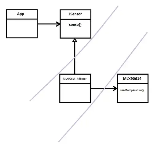

You're predicting that using DIP will mean you can't reuse your sensor code without dragging stuff along with it. Here you have the relationship backwards.
You don't create the interface ISensor for MLX90614. You create it for the App that depends on having a sensor and doesn't care if it's MLX90614 or something else. Where before your app knew about MLX90614 directly now it is simply publishing an interface detailing what it needs from it's sensor. Whatever it is. That's a good thing. The app may live longer than MLX90614 does.
When it comes time to use MLX90614 in another app you should use a different interface. One that shows what the other app needs. Not everything MLX90614 does. That's the interface segregation principle.
For some reason you insist that MLX90614 needs to be able to be moved from app to app untouched by the experience. Maybe you're thinking of putting it in a library. If so I'd consider the Object Adapter Pattern to keep from getting it's stubbornness all over my app.
Do what you like with your banana. But the gorilla is the one that decides what it wants to eat and how to peel it.

  • Let's say I want to release the code for the MLX90614 as a standalone library for others to use with their devices and projects. I probably don't want to be depending on the application specific interfaces for the standalone library. In that case, would it be better to create the standalone class first, then create an Adapter when it's time to insert it into my application? Or is this adding an unneeded complexity? – Ryan Mullin Mar 29 '18 at 07:59

  • Since MLX90614 is a standalone library and is unaware of the application specific interface(s), I think OP is asking how it can possibly implement said interface(s). Which strikes me as a very good question. – user949300 Mar 29 '18 at 11:11
  • @Rahul Agarwal in this case, is the interface packaged with the app, or with the sensor? Or is it put in a standalone package that both depend on? If it's in the same package as app, then as I said I have to drag the whole forest with me to get the banana. If it's packaged with the sensor then that makes things much easier, but the app package still depends on the sensor package so the dependencies haven't been inverted at the package level. If I place the interface in its own package then now I can reuse both parts, app and sensor, but I have to bring along a separate package with it. – Ryan Mullin Mar 29 '18 at 14:35
  • @CandiedOrange I understand what's going on, but you still haven't clarified to OP that both `interface ISensor` and `class MLX90614_ISensor` are in the application. And, BTW, what if OP follows the "experts" and makes MLX90614 `final`? Your answer would be improved by being more explicit. – user949300 Mar 29 '18 at 18:40
    @user949300 better? – candied_orange Mar 29 '18 at 21:35
