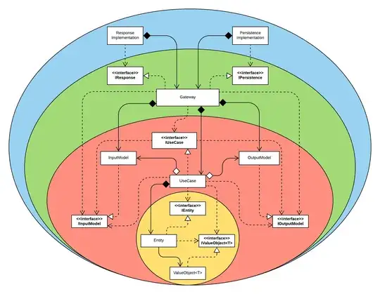

Before going further on this question, to give you guys some more background, here is my architecture (NOTE: still incomplete):
My Clean Architecture Proposal
The rules I am following in this architecture is:
  1. A layer can only know about its immediate innermost neighbor layer's interfaces
  2. A layer cannot know anything about any outermost layer
  3. All communications between layers MUST be done through interfaces
  4. Each layer must be independently deployable
  5. Each layer must be independently developable
To better understand the arrows in this diagram, I recommend reading those Stack Exchanges's questions:

Now, the challenge I'm facing right now, is finding a good way to use the validators. I'm not satisfied with my architecture in this point. The problem is the following:
Since I can have thousands of Value Objects being instantiated at a given time, I don't want each instance of the Value Objects to have an instance method to perform the validation. I want the validation method to be static, since it's logic will be the same for every instance. Also, I want the validation logic to be available for the upper layer of the architecture to use to perform validations without trying to instantiating the Value Objects, thus causing an expensive exception to be thrown.
