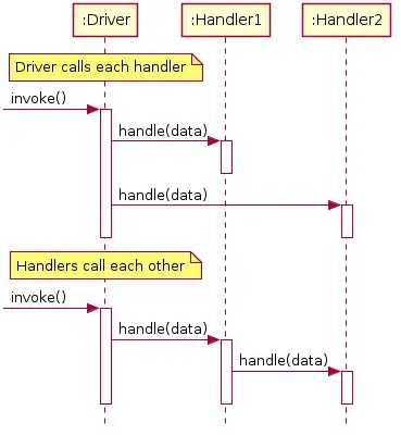

This means that during execution data will be passed first to handler-1 and then to handler-2.
It's not 100% clear what you mean, but I'll show you two ways to show this in UML with a sequence diagram:
UML Sequence diagram showing data passed to handlers
But configuration can be changed so that flow is handler-2 and then handler-1, or even handler-2, handler-1, handler-1, handler-2.
You can use the same notation as above to show each case.

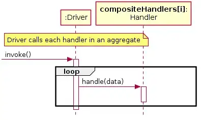

And what if handlers can be composed/combined?
Again, sequence diagrams are pretty explicit, so you have to be precise. One way you can show general calling of a method inside a list of elements is as follows:
UML Sequence diagram showing data passed to an aggregate of handlers
As you mentioned, in UML you could (should) complement this with the static structure of the aggregate (composition) of handlers with a class diagram.
