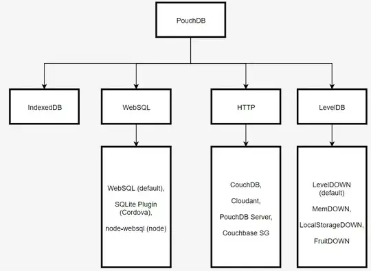

The best practice is to use persistent storage which facilitates offline-first development and offers built-in client/server data sync, such as PouchDB/CouchDB:
The PouchDB API provides a method for bidirectional data replication. It accepts the live option, so that all changes continue to be replicated, and the retry option, to attempt replications if the application goes offline.
We can also subscribe to the changes feed so that after receiving a change — either from the remote server or the local user — the UI is updated, either by creating, updating or deleting a document.
Use SQLite to store the data locally in the React Native app and add an adapter which matches one of the APIs supported by PouchDB to push data back to the server.
PouchDB Adapters
