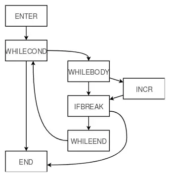

I am not convinced your control flow graph is correct because it shows two terminal nodes 9 and 12. Instead, there should be a single terminal node for the return.

It is worth noting that the control flow if (cond) { a(); } else { break; } b(); is equivalent to if (!cond) { break; } a(); b();. Keeping that in mind, we can separate the code into basic blocks. A basic block starts with a jump target, and ends with a jump or branch to another basic block.
If you split the source code into more basic blocks that is not a problem. It will still lead to the same complexity, as an unnecessary block adds one edge and one vertex to the control flow graph, which cancels each other out. Here are the assembly-style basic blocks I chose:
ENTER:
  jump WHILECOND
WHILECOND:
  branch condWhile ? WHILE : END
WHILEBODY:
  branch condIncr ? INCR : IFBREAK
INCR:
  jump IFBREAK
IFBREAK:
  branch condNoBreak ? WHILEEND : END
WHILEEND:
  jump WHILECOND
END:
  return
We can now draw the control flow graph:
control flow graph
This is a fairly complex graph, but I've tried to lay it out as a planar graph that corresponds roughly to the appearance of the source code.
There are a number of substantial differences to your graph. E.g. you only have a single path that leaves the loop. This ignores that both the loop condition and the break can leave the loop. And once you enter the loop body, your graph does not continue.
We can the see that the CC of this function is 4, either by applying the formula or by counting independent paths by hand.
This also shows that CC as a metric of software quality has its limits. The code you've shown is very complex and not easy to understand. Yet it has the same CC as this much simpler method (note that && is a control flow operator):
