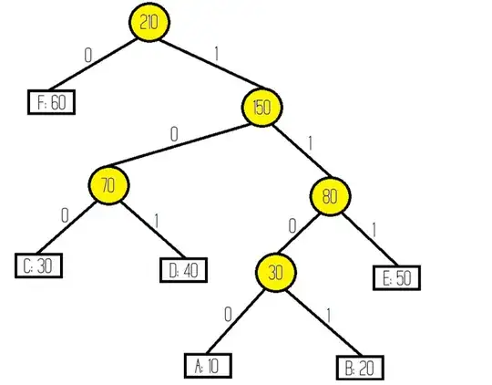

I solved the question but my teacher said that I made the wrong tree. Kindly check my answer below and tell me where I am wrong?
MY ANSWER:
Final Binary Tree:
Final binary Tree
Variable Length Code:
Variable Length Codes
Kindly tell me where I am wrong? What wrong I did while making the above Binary Tree?
Choose the two lowest frequencies, and make them brothers, with the root having the combined frequency.
You did this once for A=10, B=20 for a total of 30, right?
Next you picked C=30, D=40 for a total 70. But there was a better choice, as there are two nodes with score of 30 for a total of only 60. One of them is C=30, and the other? Well, think more dynamically.
