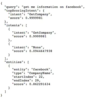

Have a look at the Microsoft LUIS offering
https://azure.microsoft.com/en-us/services/cognitive-services/language-understanding-intelligent-service/
I believe amazon have a similar api offering as well.
These allow you to utilise NLP and other AI systems in your apps without having to program your own. You just call the API and get json back with the sentence broken down into subjects and intents.
here is an example of what you get back from LUIS enter image description here

  • @ewan I took a look at Amazon Comprehend, and I'm not sure it does exactly what I want -- it seems to be able to tokenize a document and group tokens by their entity type (i.e. business, place, person, etc) but it doesn't seem to be able to associate entities together unless I'm missing something. – Benjewman Jan 14 '18 at 23:11
  • I've not used that one. It wont do the entire job for you. You need to train it and interpret the results. You can do quite complicated setup, for example "im going from x to y" – Ewan Jan 14 '18 at 23:31
