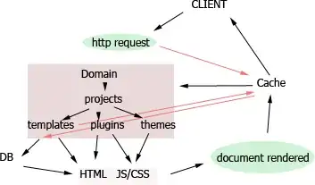

my framework logic - abstracted without all the details : my framework logic - abstracted without all the details

  • thanks for answer; i've spent lots of time conceiving my framework to fit my mind & my logic & everything is separate (i even wrote a tiny templating language); each template is a list of call to individual components, so a new template can be created & applied in seconds to any project. components & plugins have their own separate folder and are activated on a project through an ini file & the backoffice (the content manager place them anywhere they want in 4 to 5clicks, then cache is cleared, html, css & js are rebuilt at next request & put in cache). – mikakun Dec 11 '17 at 19:28
  • it's easy to maintain, was so far. However there is a glue that hold everything together (apache/php spl_autoload` & the classes i use and i wrote for my logic); so it's very true my boxes cannot exist outside of my framework. and that's probably a flaw in my design. however they can totally contain anything - as long as it is plugged correctly obv – mikakun Dec 11 '17 at 19:28
