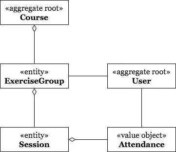

There is a student attendance tracking system that keeps records of student attendances of ExerciseGroups.
  • Course is a top-level component, AR, describes a generic info about the learning course (name, description)
  • Every Course has ExerciseGroups that describe groups where students can practice. ExerciseGroup holds the name of the group and list of signed-up students and tutors. ExerciseGroup has no sense outside the Course (from the domain), therefore it's under the Course AR.
  • Every ExerciseGroup contains a list of Sessions that describe occurrings of the ExerciseGroup a User can attend. Is defined by (datetimeBegins, datetimeEnds and a set of Attendance objects).
  • Attendance is a VO record that holds info about student attendings. Contains a reference to the User (via Id) and some statistical data.

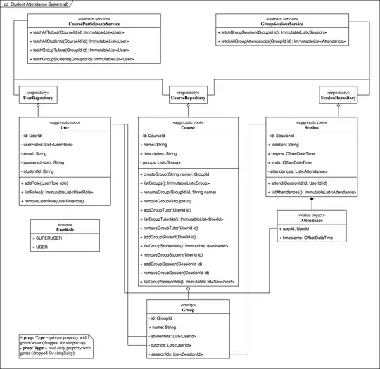

A day after (update)
I revisited my model and found it very fat, hard to maintain and designed with false invariants in mind that caused transactional failures. Nothing about creating a new session item should logically interfere with editing a course for example.
What I came up with after deeper transactional analysis is the following model (clickable): enter image description here
The question I was using to separate boundary context is: can/should this and that in the same transaction? When you Session#attend, should it be done in the same transaction with Course [blocked]? Definitely it's not etc.
To fulfil the condition that session should not be outside the Group, I just put GroupId to the Session's controller and hope for eventual consistency :)

ovnia
  • 461
I would turn the model upside down to make the most interesting / behavioral bits your AR.
Based on the info you provided, this is what I would do:
  • Course is a reference entity (not an AR)
  • User is an reference entity
  • Exercise Group is a reference entity (can also record a link between Course and User)
  • Session and/or Attendance are the only concepts with potentially interesting behavior
    • All other entities are only interesting because of their interaction within a Session or Attendance
Attendance would contain references (ids) of Session and User, and maybe other stats. You can discover which course the users attended by following the session -> exercise group -> course relationship.
Domain question: Is it necessary that Users only attend sessions for which they were in the exercise group? Would the people in the session turn away a person that showed up, even though they were not in the exercise group?
You could say that certain configuration changes such as joining and leaving groups could be interesting behavior. It depends on what the goals are.
Also keep in mind that your domain (write-side) model does not have to be the same as your read model. Trying to mix query and domain concerns can have you running in circles. As much as possible, let the domain just be concerned with modeling the business problem. If necessary copy the domain data into other forms that are easier to query against. E.g. database triggers, ETL jobs, code that runs on save, etc.
Many of the questions you posted would not really apply with what I said above, so I didn't answer them directly. Feel free to ask any other questions you have about my answer in comments.
Kasey Speakman
  • 4,341
  • 26
