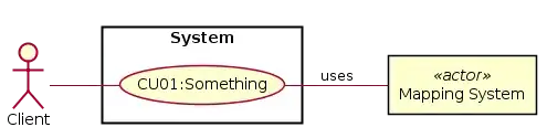

... wondering if "Google Map API" should be an external actor to my system or not.
UML not being a methodology, you can decide. Craig Larman's UML approach proposes using the external service as supporting actor:
It might be interesting to abstract it to a Mapping System (rather than Google Maps), since this is a service provided by Apple, Google, Microsoft, etc. Each has likely a different API, but you could develop an adapter interface, so the core aspect of your internal system wouldn't need to know the details. Larman's book does a great job to explain how that could work.
