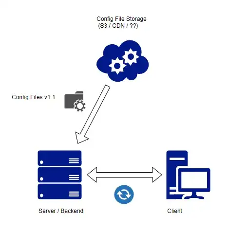

Create an API that allows the source of the "truthiest" file to speak to the server. Push this new file to the server's cache whenever there is a change. Then, whenever the client talks to the server, check the client's file version/hash and compare it to what we have. If it matches, proceed, else we either 1) force the client to update, 2) tell the client to update manually (meaning we deny it access until then) or 3) have a version leeway that will give enough time for the client to update, in theory.

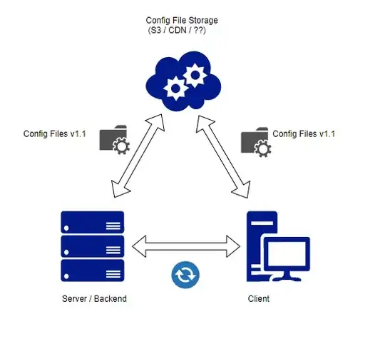

Solution B) Both the client and the server make calls periodically to see if there is a new config. When the client speaks to the server and the versions do not match, we have the 3 options again, only this time the server has to make calls to the storage (the truthiest source) to check which version is the correct one. enter image description here

EDIT: You have recently added diagrams A & B. In (A) you propose client refreshing "same file" from servers. I am suggesting that intermediate "transparent" caches can confound that arrangement, and that is is appropriate to occasionally tell the client a new config file name so he will suffer cache miss and will retrieve from server. In (B) you have even less control over caching effects, so inventing a new config file name is even more important, to deal with the "older data from S3" issue that you mention. The synopsis is simply that you publish the content under each filename exactly once, and rev the filename when you rev the content. That way you can avoid heavier weight approaches like Paxos/ZK. You just need to push a new rev at time t0, wait N seconds until your servers have a copy of it, and then after t0 + N the servers are free to send the new name to clients so clients will use it. This offers consistency with very little effort. Alternatively, assume the load balancer hashes a given client to a single server, so within the brief interval it takes for all servers to get a fresh config, clients will only communicate with single server and therefore will trivially be in sync with that server.

  • I'm a little unclear on why you would want to have the server depend on the CDN. Can you elaborate at bit? Would it be possible to add a simple diagram to your question? – JimmyJames Nov 28 '17 at 15:01
  • I added diagrams and rephrased my proposed solutions. Please check and let me know if that helps. – turnip Nov 28 '17 at 15:57
  • I'm still unsure about what advantage you get from distributing this data to the servers via CDN. I can see why you want to do that with the clients but you have control over the servers, right? I'll add to my answer. – JimmyJames Nov 28 '17 at 16:19
