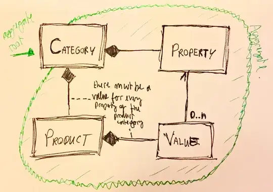

Option 1: your original design
You made Category the root of a single aggregate. On one side, this makes sense, because the aggregate shall ensure consistency when its objects are modified, and Product must have the Properties of its Category:
But on the other side, the single aggregate means that all its objects are related to a root that owns them, and all external references must be made via this aggregate root. This implies that:
  • one specific Product belongs to one and only one Category. If the Category is deleted, so are its Products.
  • a specific Property belongs to one and only one Category. Otherwise said, if "TV screens" and "Computer monitors" would be two categories, "TV screens:size" and "Computer monitors:size" would be two different properties.
The second point doesn't correspond to your narrative: "But what should I do when I just need to add a new Property that does not belong to any category". And it's not clear if the same Properties can be used in different Categories.

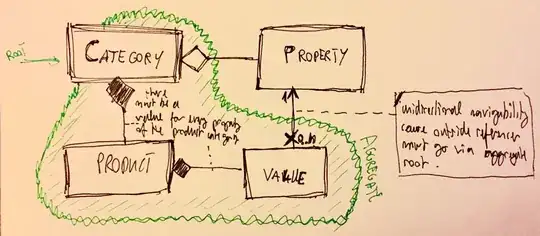

Option 2: Property outside the aggregate
If a Property exists independently of the Categories, it must be outside the aggregate. And the same if you want to share Properties between Categories (which makes sense for height, width, sizes, etc...). This seems definitively be the case.
The consequence is on the link between Property and things that belong to the aggregate: while you can navigate from the inner of the aggregate to Property, you are no longer allowed to go directly from a Property to the corresponding values. This navigability restriction can be shown in an UML diagram:
Note that this design doesn't prevent you to have a List<Property> in Category, with a reference semantic (e.g. java): each reference in the list refers to a sharable Property object in a repository.
The only problem with this design is that you could change a Property or delete it: as it's outside of the aggregate, the aggregate can't take care of the consistency of its invariants. But this is not a problem. It is the consequence of the DDD principles and the complexity of real world. Here a quote from Eric Evans in his seminal book "Domain-Driven Design: Tackling Complexity in the Heart of Software":
Any rule that spans AGGREGATES will not be expected to be up-to-date at all times. Through event processing, batch processing, or other update mechanisms, other dependencies can be resolved within some specified time. But the invariants applied within an AGGREGATE will be enforced with the completion of each transaction.
So yes, if you change a Property, you'll have to make sure that a service checks the Categories referring to it are updated as needed.
