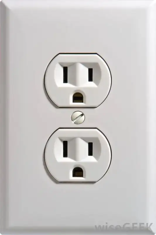

Interfaces exist for one reason, and one reason only: to allow different implementations to be created that are all compatible with the interface.
This interface
Accepts these implementations
More specifically, the appliance at the end of those cords can be anything that satisfies the interface contract, which is 120 volts AC at 60 Hertz, drawing less than 12 amps over 14 gauge wire.
The wall socket neither knows nor cares what is at the end of that cord, so long as it meets the socket's electrical specifications.

  • Hm, 12 amps? Or 15, but at 80% continual load? [Diy.SE](https://diy.stackexchange.com/) would be proud. –  Nov 12 '17 at 05:32
  • @Snowman: Or 20 amps if you use 12-gauge wire, though not to a single outlet. Yeah, you can tell I'm not an electrician, but I do occasionally wire up light switches and outlets. – Robert Harvey Nov 12 '17 at 16:01
