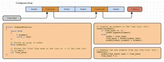

I'd largely echo Chris' answer but with some possible deviations. The ultimate thing I'd echo wholeheartedly is to store indices to your particles and contacts, stored in big sequences like a couple of big vector pers network.
However, one part where I disagree is that you can use indices and a random-access sequence and still have constant-time removals (with a super small constant) without index invalidation if you use an indexed free list/holes strategy. If particles die, then you can remove them in constant-time and reclaim/insert in constant-time without using any extra memory, like so:
... where union Nodes nodes[n] might be std::vector<union Node>. It takes a little more elbow grease if Particle or Contact isn't trivially constructible or destructible (making a proper container in C++ for non-PODs is a bit of a PITA with placement new, aligned storage, and manual dtor invocations). Hopefully they are, as generally can be the case for this type of data.

A quick thing in practice using the above techniques (including the indexed free list), and not really "particles" in this case but still agents that collide with each other and a collision list between agents (gathered all at once into two vectors of integers as shown above): 500,000 agents bouncing off of each other, single-threaded, with a good portion of the time spent just plotting pixels and not merely simulating:
