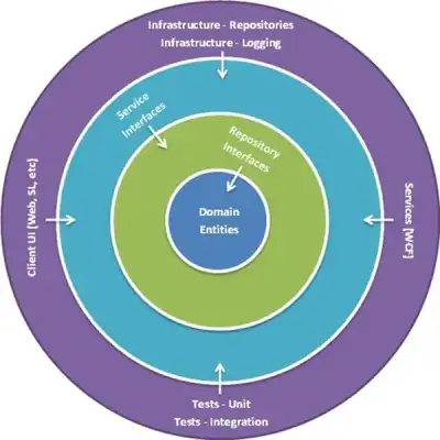

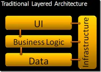

There is nothing at all required of you from a project/folder perspective to establish an Onion architecture, though the layers in the model do suggest natural places to put project/API boundaries.
Take a look at this diagram:
Now have a look at this one:
Other than the shape of the diagrams, do you notice anything interesting?
The only material difference between these two diagrams is that the Onion diagram only allows access to the database through the Data Access layer. In the "traditional layered architecture," the UI and Business logic are allowed direct access to the database and other IT systems (what the author is calling "infrastructure"). In the Onion Architecture, the only thing allowed access to the database are the Domain Entities. You will note that most of the interaction with this architecture occurs at the Service Layer boundary (the outer ring).
That's all there is to Onion Architecture, really. There's nothing special happening here, other than a stricter separation between layers. In fact, I'd say that the way Onion does it is probably the most common way that business domain software architectures are expressed nowadays. I'd have to go all the way back to Winforms or ASP.NET (both of which use code-behind extensively) to find an architecture that looks more like what this author calls "Traditional Layered."
