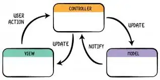

That's certainly not Clean, Onion, or Hexagonal Architecture. That is this:

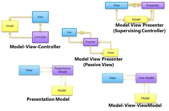

Not that MVC has to be done that way
You can use many different ways to communicate between modules and call it MVC. Telling me something uses MVC doesn't really tell me how the components communicate. That isn't standardized. All it tells me is that there are at least three components focused on their three responsibilities.
Some of those ways have been given different names: enter image description here
And every one of those can justifiably be called MVC.

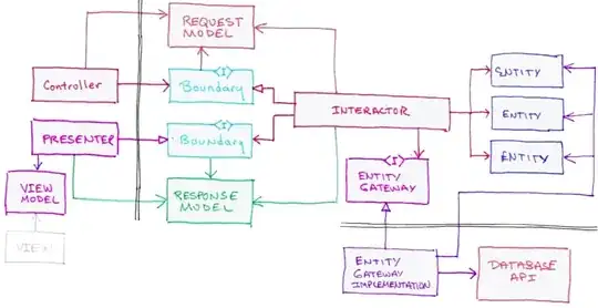

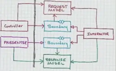

Anyway, none of those really capture what the buzzword architectures (Clean, Onion, and Hex) are all asking you to do.
Add the data structures being flung around (and flip it upside down for some reason) and you get:
One thing that should be clear here is that the response model does not go marching through the controller.
If you are eagle eye'd, you might have noticed that only the buzzword architectures completely avoid circular dependencies. That means the impact of a code change won't spread by cycling through components. The change will stop when it hits code that doesn't care about it.
Wonder if they turned it upside down so that the flow of control would go through clockwise. More on that, and these "white" arrow heads, later.

The important thing about that "white" arrow is that it lets you do this:
You can let the flow of control go in the opposite direction of dependency! That means the inner layer doesn't have to know about the outer layer and yet you can dive into the inner layer and come back out!
Doing that has nothing to do with using the "interface" keyword. You could do this with an abstract class. Heck you could do it with a (ick) concrete class so long as it can be extended. It's simply nice to do it with something that focuses only on defining the API that Presenter must implement. The open arrow is only asking for polymorphism. What kind is up to you.

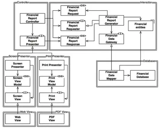

With his Clean Architecture, Uncle Bob's attempt is to synthesizes a bunch of known architectures to reveal important concepts and components for us to comply widely with OOP principles.
It would be counter productive to consider his UML class diagram (the diagram below) as THE unique Clean Architecture design. This diagram could have been drawn for the sake of concrete examples… However, since it is far less abstract than usual architecture representations he had to make concrete choices among which the interactor output port design which is only an implementation detail
Uncle Bob's UML class diagram of Clean Architecture
