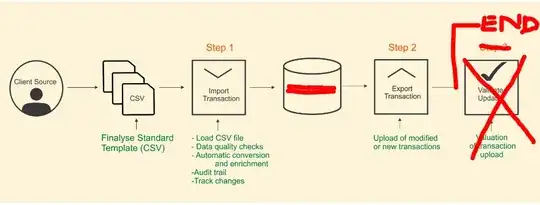

I want to develop a robust system written in C# (WPF and WCF) for importing .csv files (and/or some others e.g. Word files) as a input into my system and then to generate PDF/Word report.
I would have database, and application will be a desktop app.
I am just wondering is there any approach for multiple customers apart from creating as many forms as customers? (1 form - 1 customer, 5 customer - 5 forms) depending on specific request of each of them?
Picture is below.

Lets say you have two different customers with similar, but not completely different requirements. Maybe you need to display individual company logos at the main form, maybe there is a checkmark for an extra option only required by one of them.
To reuse the same form for such a case, you need to make your application customizable. So when a user logs on to the system, the authentification process should provide your application with the information to which customer the user belongs to. So it can retrieve a customer-specific configuration (maybe fron the database, maybe hardcoded in your application), and change the user interface accordingly. For example, the customer-specific configuration might contain different file names for a companies logo in form of a picture file. The form initialization code can take this file name and display the correct picture at its top. Or, there is a boolean configuration option for displaying the new checkmark, then the form initialization can enable or disable that checkmark accordingly.
Of course, if the requirements become too different, at some point it makes more sense to create an individual form for a new customer, for example when there is a specific use case which is not part of the requirements of the other customers. This is a judgement call you have to make for the individual case.
