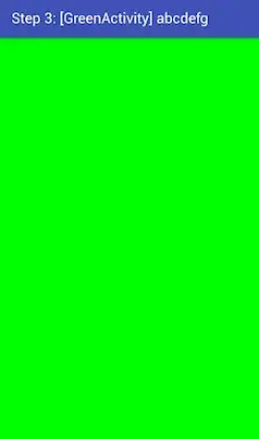

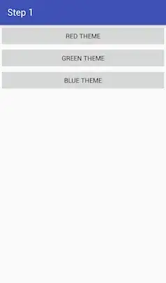

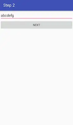

For example, assume my app has 3 steps with 3 pages:
Step 1 : MainActivity: choose color
Step 2 : EditTextActivity: input text
Step 3 : GreenActivity: display color and input text
In EditTextActivity, which activity to go after Next pressed depends on previous MainActivity, so I write a switch case to do that:
