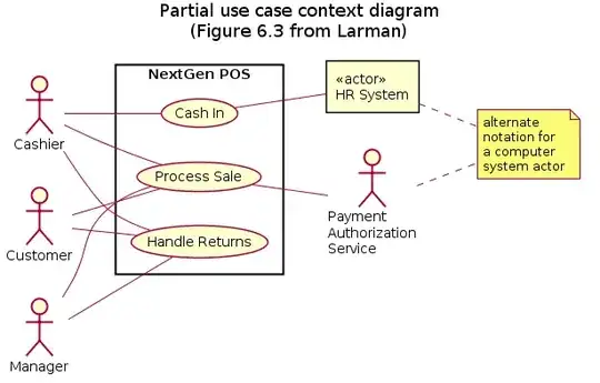

  • Use-case diagrams can show the intended features and interactions with users or external systems. enter image description here

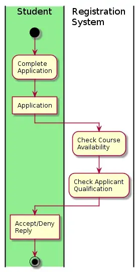

  • Activity diagrams can show business processes that a software needs to support. enter image description here

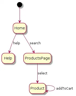

  • State diagrams could show intended dynamic on a web site: enter image description here

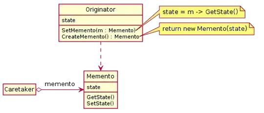

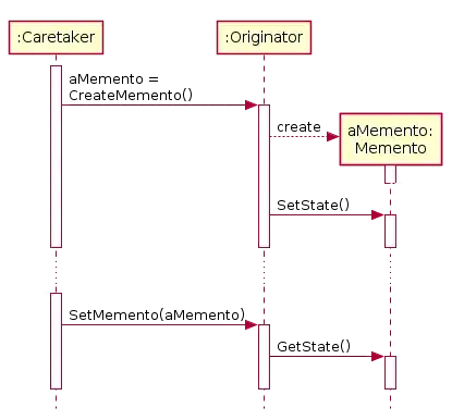

  • Gang of Four design patterns are presented as static and dynamic models. For example, Memento:
