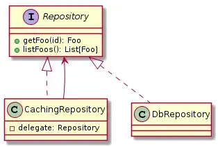

You can use a proper design to achieve the best of both worlds. You could use the decorator pattern as Vincent suggested.
In this design you have CachingRepository that implements your repository interface and has an instance of the repository that it delegates calls to (when there is a cache miss). This design separates the concerns of caching and fetching entities, but invisibly to the client of Repository.

    What you show here is actually an implementation of the decorator pattern. – Bart van Ingen Schenau Aug 09 '17 at 19:58
  • Is it? Every example of the decorator pattern I've found uses an abstract decorator class and concrete decorator classes. – Samuel Aug 09 '17 at 20:03
    Yes it is. The Decorator abstraction doesn't have to be an abstract class - it just has to define a common interface. In this case, this is defined with the Repository interface, while your CachingRepository is a concrete decorator class. – Filip Milovanović Aug 10 '17 at 07:16
