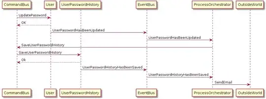

In your case you cannot just process all three things at once. What you need is a process. Here is an extremely simplified example:
Command and event orchestration
It is important to know that state altering operations MUST be always made on a consistent entity. Unless you can guarantee strong consistency, it has to be made on a master record.
Your system should guarantee that before any event is raised in your system changes MUST be persisted with transactional safety first. This is to ensure that a raised event really is a confirmation of what really happened.
There are several tricky parts of the process as is and I am going to ignore the obvious ones - such as: What if your database server dies when persisting a user with changed password? You simply issue the UpdatePassword again. However, some parts need to be taken care of by you, and these are:
  • handling message duplication,
  • handling e-mail sending.
In a system, process orchestrator (PO) is nothing else but another entity, which contains internal state - in the literal term as well - and allows transitions between the states, effectively acting as some sort of state machine. Thanks to the internal state you can remove message duplication processing.
When the PO is in a New state and processes UserPasswordHasBeenUpdated, it changes its state to UserPasswordHasBeenUpdated (or whichever state name works for you). Should the PO still be in a UserPasswordHasBeenUpdated and another UserPasswordHasBeenUpdated would arrive, the PO would completely ignore the message, knowing it's a duplication. Similar mechanism would be implemented for other states as well.
Handling the actual sending of the e-mail is a little bit trickier. Here you have two options:
  1. send it at most once,
  2. send it at least once.
Send it at most once
With this option, when the PO reached UserPasswordHistoryHasBeenSaved state a command to send an e-mail is dispatched as a reaction to the state change. Your system would ensure the UserPasswordHistoryHasBeenSaved state would be persisted before sending the e-mail, i.e. duplicated message would not trigger the e-mail sending again. With this approach you ensure that the correct state is saved for the PO but cannot guarantee any following operation.
Send it at least once
This is what I would go for.
Instead of saving UserPasswordHistoryHasBeenSaved and sending out the e-mail as a reaction to it, you try to send the e-mail first. If the sending operation fails the state of the PO is never changed to UserPasswordHistoryHasBeenSaved and another message of the same type is still processed. Should sending of the e-mail actually succeed but your system would fail during persisting of the PO with its new UserPasswordHistoryHasBeenSaved state, another message of the UserPasswordHistoryHasBeenSaved would once again trigger the command to send out the e-mail and the user would have received it multiple times.
In your case you want to make sure the user actually receives the e-mail. That's why I would choose the second options over the first.
Andy
