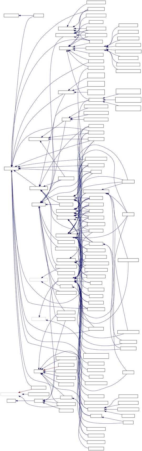

The test group is fairly rigid, given the interdependent nature of the software, that for any single change they need to re-test everything. To give you an idea of the interdependence I have attached a class inheritance diagram below.
Nightmare of Multiple Ineritance
As you can assume, this structure is a nightmare to maintain. I suppose I'd like to hear from you if you have ever encountered an architecture such as this as I tend to prefer single, linear inheritance models. It appears that the original developer utilized inheritance for functional augmentation, rather than creating members, or allowing access to other class pointers to provide the additional functionality, it was done through multiple inheritance, sometimes inheriting from up to five parent classes.

  • Whats with the red arrows? – candied_orange Jul 21 '17 at 13:20
  • @CandiedOrange, Doxygen was used to generate the diagram, I manually stripped the names. Red is protected inheritance. [Diagram Legend](https://heim.ifi.uio.no/naeemk/madwifi/graph_legend.html) – vectoralpha Jul 21 '17 at 13:30

  • interesting to hear your story as well. I am pushing more in the direction of re-write due to the interdependent nature of the software as well. As you can see from the class inheritance diagram it is very difficult to introduce interface layers into the existing software. That, and the many deficiencies that the software currently has makes things more problematic. – vectoralpha Jul 21 '17 at 16:23
  • Due to firewall issues I can't see the diagram (everything on imgur is blocked). The hardest part is introducing the changes needed to introduce those interfaces, breaking the static accessors that side-step the design etc. I was lucky enough to have a few places where I could do that intelligently. You might not be able to introduce the modularity up front, but it helps to have a target design. Come up with a plan that makes sense for your project. The key is to limit your rewrite to give you the biggest reward for moderate effort. – Berin Loritsch Jul 21 '17 at 16:35
  • Sorry to hear about your firewall problems. In case you haven't had a chance to checkout the graph outside of that restriction I put it on google drive, here is a [link](https://goo.gl/6WknPG) to check that out. I am working on an intelligent modular design that allows the scalability that my company requires. There isn't a lot of software in the current system that is worth re-using in a new architecture. So a lot of what I am planning on implementing will be new. – vectoralpha Jul 25 '17 at 14:05
