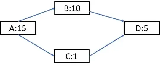

This lead to a 'fail slow' problem. Imagine the following dependency scenario - where each letter is a module, and each number is a version:
Now imagine we make a series of changes to D and B and A, forgetting C.
C has gotten left behind (and is still pointing to an old version of D).
Now when the person who has to make a change to C does it - they find that all the changes to D have broken C in multiple ways. Fixing C now takes days.

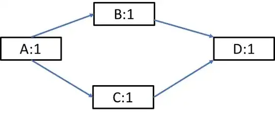

So the team came up with a different plan. Fail fast.
Now everything that was a version number above is now LATEST. (Note this is maven 2 not maven 3).
This means that any breaking change to D, will show up in B or C the next time it is built. (The key phrase here being the next time it is built).
Now let's assume that module A is the parent web application that developers use. Now a developer checks in a change to B - for which B compiles (and A works on their machine). A however has had several checkins - and the version of B:LATEST now breaks with A:LATEST.
We have a fail-fast strategy - but there is nothing in version control to show what broke the app. (And potentially 40 modules to look at to see what the root cause is.)
