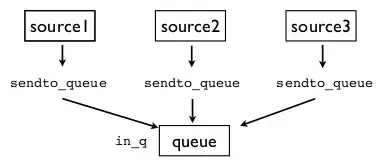

Generators can be used to multiplex data from multiple sources, using threads.
