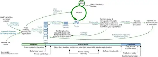

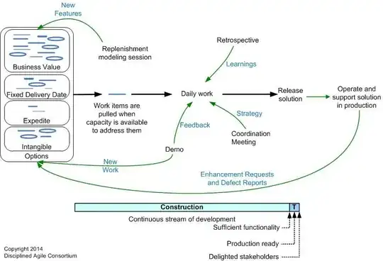

I think that this diagram, based around Disciplined Agile Delivery, gives a good pictorial representation of a lean software process:
Advanced/Lean DAD Lifecycle
Continuous Delivery DAD Lifecycle
The events of the Daily Standup and Sprint Planning are captured across the Coordination Meeting and Replenishment Modeling Session. Coordination Meeting is more like a Daily Standup from Scrum and a Replenishment Modeling Session is more like Backlog Refinement and Sprint Planning. However, it's OK to bring in some requirements discussion into the Coordination Meeting if that works for your team.
Like most things in a lean process, this happen just-in-time. There are no timeboxes and events don't happen on a particular cadence like they do in Scrum. You do the work when it adds the value for the team and stakeholders.
Which you can compare to a pictorial representation of a process based on Scrum modeled in the context of Disciplined Agile Delivery:
Basic/Agile DAD Lifecycle Extending Scrum
Instead of constraining yourself to 2-4 week Sprints with planning at the start, daily stand-ups, and a review and retrospective at the end, leaner methodologies will enact your demonstration, coordination, and retrospective meetings whenever the stakeholders think that it is appropriate.

  • Thanks Thomas - For us, the initial "modeling, planning and organization" phase shown in your diagram is done outside of the sprint as a pre-planning step. It involves PO/BA (as well as scrum master and architect). For this reason, the first time the Dev and QA teams know about the new requirements/features is at the point of Sprint Planning. – ziggy Jul 08 '17 at 09:42
  • @ziggy I added the diagram that captures Scrum in the same Disciplined Agile framework. "Initial modeling, planning, and organization" is what many teams call "Sprint 0" (which isn't part of Scrum at all - Scrum is silent on project inception activities). The "iteration planning session" is your Backlog Refinement (grooming) and Sprint Planning. In Scrum, Sprint Planning happens on a particular cadence. In a leaner process, "Coordination Meeting" and "Replenishment Modeling Session" includes planning and stand-up and happens when necessary, not on a particular cadence. (1/2) – Thomas Owens Jul 08 '17 at 10:01
  • @ziggy Note that Disciplined Agile is its own framework, so it doesn't use the Scrum framework terms. That's why there's a little bit of mapping. DA is a framework that supports a variety of agile and lean product development processes. It should be close enough for you to map your existing Scrum work to the things in the third diagram, and then see how all the timeboxes and iterations are gone once you move to a leaner process, yet all of the work remains done. (2/2) – Thomas Owens Jul 08 '17 at 10:11
