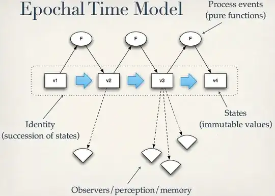

More generally, I think there's a bit of confusion in Khorikov's essay: we don't validate entities, we validate state. The entity is just an identity progressing from one state to the next.
For more on this point, see Stuart Halloway's 2011 talk.
The state that you are validating is a value object, in Evans's language.
Throwing an ArgumentException in the constructor when the state you've been given doesn't satisfy your invariant is a perfectly reasonable thing to do.
