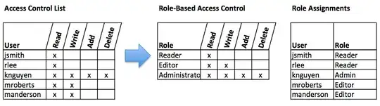

When reading about ACL and RBAC I seem to understand it easily - there are either usernames or roles that are given access to an asset. I can also see how I could implementing those.
i.e. this image gives a clear view of ACL and RBAC for me (as in I can go on and design database tables based on above): enter image description here (Image courtesy of pressbooks)
