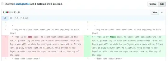

  • really minor, but GitHub's diff mode is "Unified" by default, which displays a horizontal scrollbar. However, if you click "Split", GitHub's diff soft wraps: GitHub diff split view

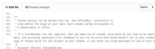

  • GitHub's viewer does NOT support wrapping, and its width is 128 characters (though some "GitHub wide" user styles exist).

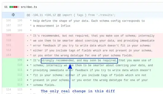

  • inserting text in the beginning of a comment while hard wrapping each of its lines can easily cause a cascade of false diffs: Bogus diff on hard wraps
In the wild, I've seen mostly hard wraps (limited line length), despite the diff issue above being rather common and jarring.
