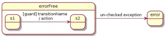

It's going to depend on your implementation of the state machine, the language and the type of exception. I added the diagram to your question for an example:
If it were Java, and action() had a try for a checked exception, you could possibly handle things well knowing that the current state was s1 and you were in transitionName (to s2). Access to all these things depends on how you implement the state machine. UML doesn't address that.
Architecturally, you could think of nested states, and unchecked exceptions take you to some error state:
If you can handle the error, you decide the next state accordingly. This might be an explicit transition in the state diagram, or not (a human operator could decide). If you're using UML as a sketch, I don't see any problem using exceptions as transitions.
