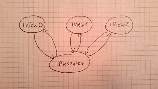

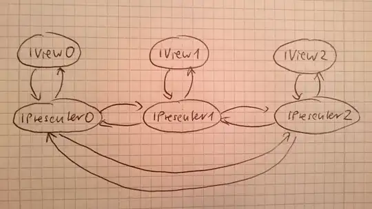

I have an Android app which I am refactoring to use MVP. I have an Activity that has two Fragments.
Scenario 1 (one presenter): The presenter "knows" each view. So, if one view receives input a presenter method is called and it could call a method of any of the views.
  • Advantage: flexible
  • Disadvantage: the presenter might get really big
Scenario 2 (three presenters): Each presenter only knows its own view and any other presenter. It calls methods only on the other presenters it knows or its own view.
  • Advantage: strict modularity, flow may be more obvious
  • Disadvantage: a lot of overhead (two more interfaces and presenter classes).

Edit: I tend to use the structure described in the first scenario. It makes the most sense to me. My only problem is, that I don't know whether this is proper MVP or I am making up something new on my own (which I don't want).

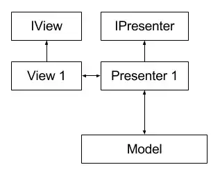

From my cursory understanding of the MVP model in Android Apps, a simple App consists of the following components.

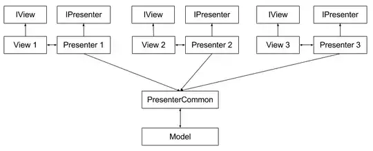

If you have an App that consists multiple Views, with each View having a corresponding Presenter, I am suggesting the following architecture.
PresenterCommon is meant to be independent of the individual Presenters. It can communicate with the Presenters using an abstract interface that is known to it but it should not know any thing specific about any particular Presenter N. Presenter N, on the other hand, is meant to be aware of the PresenterCommon and may make direct calls to it. Presenter N needs be registered with the PresenterCommon at some point.
Any changes to the Model by any of the Views is communicated to the other Viewers by PresenterCommon using an abstract Presenter interface.

  • So, the (Main)Presenter knows all the other Presenters (1,2,3)? If, yes why are the arrows only in one direction? Can't the Presenter call methods on the (Sub)Presenters? If View1 receives a button click for instance, methods would be called on the following entities in order: View1 -> Presenter1 -> Presenter -> Presenter3 -> View3? Isn't that a little too much complexity? – Willi Mentzel May 30 '17 at 07:44
  • @WilliMentzel Presenter 1,2,&3 don't know about the master controller. That's why the arrows only go in one direction. The overseer is responsible for coordinating between presenters, not individual actions on models or views. Is it too much complexity? I don't think so. I think it's less complex than having a God presenter that knows everything about every model/view. – RubberDuck May 30 '17 at 11:46
  • @RubberDuck If P1, P2, P3 don't know about the main presenter who is going to call its methods? – Willi Mentzel May 30 '17 at 11:52
  • @WilliMentzel, I updated the answer a bit to clarify a few things. Hopefully the answer makes more sense now. – R Sahu May 30 '17 at 15:23
  • @RSahu So, with API/Framework you would mean my Activity (to speak in Android terms)? The way I thought of it until now was: View1 (Activity), View2 (Fragment 1), View3 (Fragment 2). I know the concept is not bound to any Framework, but it would be nice if you would use Android terms next to the abstract ones. Thank you! – Willi Mentzel May 30 '17 at 15:27
  • @WilliMentzel, Hopefully the updated answer is useful :) – R Sahu May 30 '17 at 16:05
  • @RSahu So, if View1 receives input and View3 should update accordingly, how would that be possible if PresenterCommon does not know Presenter 3? :( I am sry for keeping to ask.. Thank u for your efforts. I already upvoted!! – Willi Mentzel May 30 '17 at 21:00
  • @WilliMentzel, PresenterCommon can communicate with Presenter N using an abstract Presenter interface. But it has to know the list of Presenters in needs to communicate any changes to the Model. Presenter N has to be registered with PresenterCommon for that to work correctly. – R Sahu May 30 '17 at 21:04
  • @RSahu I see, I was confused because of RubberDuck's comment which contradicts what you just said (doesn't it) and this confused me! :( – Willi Mentzel May 30 '17 at 21:07
  • @WilliMentzel, RubberDuck interpreted my diagrams differently than I what I meant. – R Sahu May 30 '17 at 21:09
  • @SRahu your first sketch is confusing somehow. :( maybe you could remove it? Otherwise superb answer and effort!!! – Willi Mentzel May 30 '17 at 21:12
  • Yes. I did interpret it differently. I would invert the dependencies and control. – RubberDuck May 30 '17 at 21:37
  • @RubberDuck, I thought I had the arrow directions correctly drawn for dependencies. https://www.dlsweb.rmit.edu.au/toolbox/ecommerce/dad_respak/dad_tutorial/html/dad_db3f_tut.htm. – R Sahu May 30 '17 at 21:42
  • @RSahu you drew them as intended. What I'm saying is they should point the other way. PresenterN shouldn't know that PresenterCommon exists. I'm also skeptical of having one "god" model. Each PresenterN should have its own model while PresenterCommon orchestrates interactions in between the others. This can be easily achieved by treating PresenterNs as models that raise events for PresenterCommon to react to. – RubberDuck May 30 '17 at 21:48
  • @RubberDuck, are you thinking of something along the lines of http://imgur.com/CJUhqg7. – R Sahu May 30 '17 at 21:58
  • More like this @RSahu https://i.imgur.com/lzbWvne.jpg – RubberDuck May 30 '17 at 22:23
