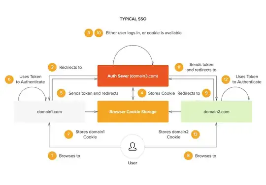

I am trying to implement Single Sign On feature(SSO). I have for now three systems that needs this feature. This SSO is relatively new to me, I have done SSO where the domain is same. There browser is no barrier so it works. So with few research i found this good article on auth0.com. https://auth0.com/blog/what-is-and-how-does-single-sign-on-work/ enter image description here
The explaination is quite straight forward. Client domains asks for authorization from auth servers which in turn sends token back to the client domain for storing in the browser.
As per my understanding:
When domain1 request for authentication to auth server, the auth server will validate the request and if successful, send auth token to domain1. Auth server will also store the token in browser? Now when domain2 ask for authorization if a token already exists then auth server will return the existing token to domain2.
If so, what is the amount of time the auth server needs to be holding the token? Doesn't the token stored in auth server be invalid after sometime? How is it refreshed?
Am i missing something?
I am trying to do this on ASP.NET, but any other language should not be a barrier for answer here I think.
In short, yes. Browser cookie and local storage is sandboxed by website. So by default domain2 cannot use domain1's token. So during the process of authentication, the browser has to redirect to the auth server's website. The auth server does the authentication or just retrieves the last auth token from browser storage. Once the token is issued, the auth server will redirect back to the requesting domain with the auth token as part of the redirect request.
In other words, domain1 and domain2 can't share a token from browser storage, so the auth server acts as a trusted intermediary and passes the token between the sites.

Think of the Auth Server as a completely normal website which has some completely standard way of authenticating users, for example:
  • Its got a database of usernames and passwords
  • It uses NTLM / Kerberos auth
  • etc...
Like any other standard website, if someone logs in with a username and password you probably want some sort of cookie to remember that user on future requests, and like any other website the expiration etc... of that cookie will depend on requirements (e.g. 20 minute sliding session, 3 month persistent cookie)
The SSO / auth token stuff only kicks in when domain1 gets involved and wants to be able to piggy back on the Auth Servers authentication mechanism. The purpose of the auth token is to let Auth Server communicate to domain1 who the authenticated user is in a secure way.
Auth Server will also store the token in browser?
It if it wants to, but it doesn't need to - any mechanism (e.g. a cookie) that lets the Auth Server track the authenticated user is fine, e.g. in the case of Windows auth every request is authenticated. As long as the auth server knows who is authenticated, it can create auth tokens whenever it likes so it doesn't need to store the tokens themselves.
Note that domain1 also doesn't have to save the token either - it can do, and its a pretty common thing to do, but it would be just as valid to write a standard ASP.Net cookie with the same expiry time and username as the auth token. Once domain1 knows who the authenticated user is, the auth token has served its purpose.
