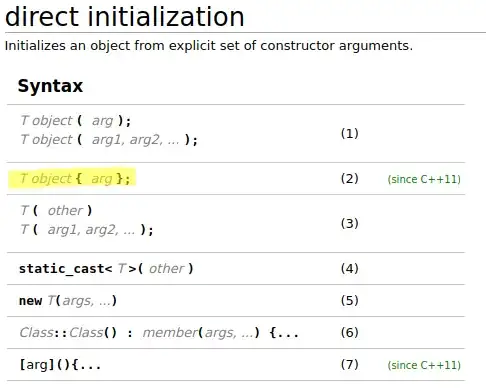

Up until now, I have been initializing most of my variables as such:
const QString foo("bar");
Which from my newfound understanding, is known as direct initialization. (http://en.cppreference.com/w/cpp/language/direct_initialization)
I was looking at someone's code, and in a namespace, they were initializing their variables with Curly Braces:
const QString foo{"bar"};
which also counts as direct initialization: enter image description here
I never knew this was a thing until today.
Code is more often read than written, what does direct initialization with Curly Braces imply as compared to Parentheses?
Just as I understand a const will tell me that a variable will not change, can I infer anything from this curly brace practice?

  • @Akiva Direct-list-initialisation (e.g. `Type a{1, 2}`) is still direct initialisation. – Angew is no longer proud of SO May 20 '17 at 13:40
