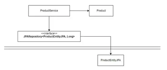

I would like to add a comment on the particular case of Spring Data.
UML Solution of Laiv and candied_orange
The solutions and arguments provided by the two authors are correct. I would just like to get into the particular case of Spring Data.
@Repository
public class DBRepository implements MyRepository{
    @Autowired
    private EntityManager em;
    public void create(Product product) {
         em.save(product)
Use of Spring Data
Product and ProductEntityJPA
But, in reality we have to use two entity :
  • One for the domain entity Product
  • One for the database entity ProductEntityJPA
As a result, the EntityManager class doesn't longer takes a Product but an ProductEntityJPA.
JPARepository interface
JPARepository interface provide all the necessary methods for the database management : save(), findAll(), etc ...
As result, we don't have to create you own method in DBRepository

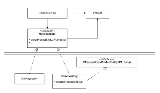

Solutions
Solution #1
Why isn't it the best :
  • We need to implement all JPARepository methods in DBRepository
Solution #2
We therefore prefer to use the methods of the JPARepository directly rather than reimplementing them.
  • Our application core is aware of the use of the JPA library. And we want to avoid this !!

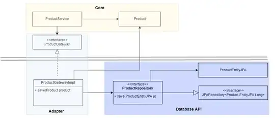

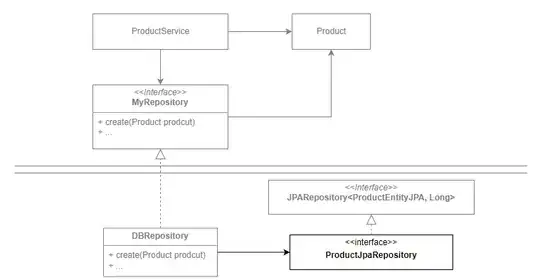

Solution #3 - add a new layer
    @Autowired
    private ProductJPARepository jpaRepository;
         jpaRepository.save( transform(product) );
    private ProductEntityJPA transform(Product product) {
        return new ProductJpaEntity( product.getX(), ...);
Why it's a good solution:
  • We take advantage of the JPARepository interface so we don't have to reimplements all methods
  • The core is not aware of the use of JPA.
Conclusion
  • We add a new layer that is an Adapter
Conclusion
In the case of Spring Data :
  • We want to have two distinct entities Product and ProductEntityJPA.
  • We want to take advantage of the JPARepository interface.
  • Solution #1 forces us to redefine all methods
  • Solution #2 is aware of the use of JPA
  • Solution #3 allows not to redefine all methods and not to be aware of JPA.
=> So the use of an intermediate layer seems necessary in Spring Data.
Finally, I change the name of the classes to match the class name in the Clean Architecure diagram.
