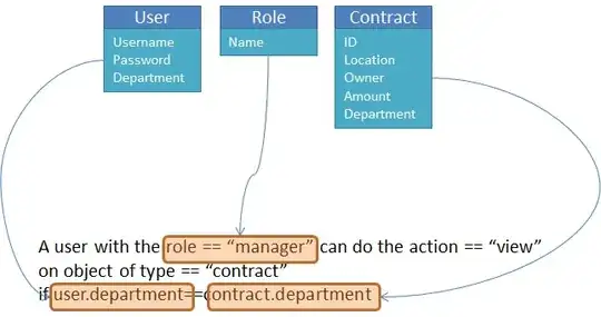

I would not use or implement RBAC. Instead I would use ABAC. Let me explain...
  • RBAC or role-based access control is about user management and role assignment. In RBAC, you get to say that Alice is a manager. You can define static permissions along with that. For instance, a manager can approve loans. So there is a link from Alice to manager to approveLoan as a permission. There are plenty of systems that will let you do that so you do not need to implement your own tables. Even LDAP has support for limited sets of RBAC. That is OK so long as you have a relatively small set of roles and permissions. But what if you want to take into account specific permissions as is your case? View, delete, insert? What if you want to take relationships into account?
  • ABAC or attribute-based access control is about policy-driven, fine-grained authorization. With ABAC you can use roles as defined in RBAC and write policies e.g.
    • Managers can view documents in their department
    • Employees can edit documents they own
In your question, you essentially defined the information model. Your objects and their attributes e.g. a user (name, password, department...); an object (e.g. a contract) and so on.
Information model

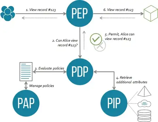

In ABAC, you would therefore entirely decouple your app code / logic from the authorization logic which is then stored as policies using attributes. The permissions themselves are stored right in the policy (see example above). The ABAC deployment architecture looks like the following
Attribute Based Access Control Architecture
The point is that if you take an ABAC approach, you write policies for ABAC (either in XACML or ALFA - there are plenty of tools for that) and you never have to custom-code or custom-implement RBAC or access control again.
