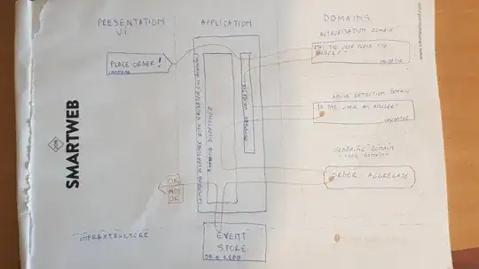

An example of how command validators work:
Command's path through command validators on its way to the Aggregate

  • Similarly, the idea of a "command validator" seems unnecessary. The goal isn't to prevent invalid commands from being created and dispatched. The goal is to prevent them from executing. For example, I can pass any data I want with a URL. If it's invalid, the system rejects my request. The command is still created and dispatched. Should a command require multiple aggregates for validation (i.e. a collection of Users to check for email uniqueness), a domain service is a better fit. Objects like "x validator" are often a sign of an anemic model where the data is being separated from the behavior. – user3347715 Feb 23 '18 at 18:49
  • @king-side-slide please keep in mind that there are a multitudine of cases, architectures and styles. A command validator is a Service in my architecture, that checks a command in an eventually consystent manner. For example, to check for authorization in a monolith. This kind of check is done outside the transactional boundary. – Constantin Galbenu Feb 23 '18 at 18:59
  • I understand that cutting through the complexity of a large system can manifest in many ways, but an object solely responsible for validating the state of something else is rarely a good solution (except possibly a *generated* object as part of the implementation of a larger system). The utility of any object is predicated on it's behavior. If all a "command validator" does is check if a command will fail after it's been dispatched, it is redundant. It simply ends up as a place for duplication and unnecessary coupling. Separating data from behavior is the antithesis of DDD. It's procedural. – user3347715 Feb 23 '18 at 20:43
  • @king-side-slide the command validator builds and maintains its own state from the events comming from other aggregate types. It's behavior and its needed state, exactly as it should be. Try to think out of the box as you don't have all the data. – Constantin Galbenu Feb 23 '18 at 21:10
  • @king-side-slide also, every command validator has only one responsibility, to reject a specific command for a single reason. So each command, before reaches an Aggregate, can be rejected by one of its out-of-bounded-context command validators. – Constantin Galbenu Feb 23 '18 at 21:24
  • Can you give me a concrete example? I'm interested in how this is implemented. Here's the flow I'm imagining: a `CreateUserValidator` is initialized (on startup?) that subscribes to *multiple* events which is then invoked with a `CreateUser` command to which it provides validation according the the events it previously received. What kind of events could it receive before the command reaches it? A `VisitorAcceptedPrivacyStatement' event? How is it not deterministic in nature? It seems like that information could simply be included on the command itself. This sounds like a distributed ... – user3347715 Feb 23 '18 at 21:58
  • ... service where, instead of having application Services which are injected with outside information (repositories etc.) that have methods which handle commands by orchestrating domain objects, you've *separated* and isolated each of these methods into their own classes named "command validators". Functionally, these seem like similar concepts (save the whole event subscribing bit). I think you've reached a hybrid between a process manager and an application service. Process managers are perfectly capable of rejecting commands (events) according to the state of the process it's managing – user3347715 Feb 23 '18 at 22:05
    @king-side-slide A concrete example is `UserCanPlaceOrdersOnlyIfHeIsNotLockedValidator`. You can see that this is a separate domain that of the Orders so it can't be validated by the OrderAggregate itself. – Constantin Galbenu Feb 24 '18 at 00:44

  • What is it about that rule that puts it in a separate domain? What data does your validator require? Is there nowhere in your domain where that data is naturally grouped? Why not? It seems like a rule like that would be grouped with whatever cross-section of your `User` can place orders (`Buyer`?). I have found that rules like your example are usually found in an anemic model. Where the code base is largely built in a procedural paradigm modeled as objects. Functions are elevated to objects and data is encapsulated and passed around for processing. Objects generally have lots of getters. – user3347715 Feb 24 '18 at 05:01
  • @king-side-slide I respond only in chat. – Constantin Galbenu Feb 24 '18 at 07:25
