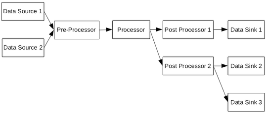

I think what you are looking for is an appropriate software architecture rather than a design pattern.
In your case, I think it will be helpful to study dataflow architecture and employ it in your particular situation.
I see the following distinct types of components in your architecture.
  1. Data source
  2. Pre-processor
  3. Processor
  4. Post-processor
  5. Data sink
The simplest instantiation of the architecture will consist of:
Simple Dataflow Architecture
A slightly more complex instantiation of the architecture may consist of:
More Complex Dataflow Architecture
