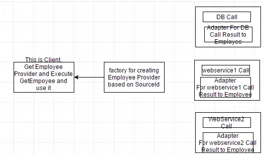

looks like you are already doing all necessary things it just need some restructuring. 1 possible way enter image description here
Please share if you are doing something different, I am also learning through this
