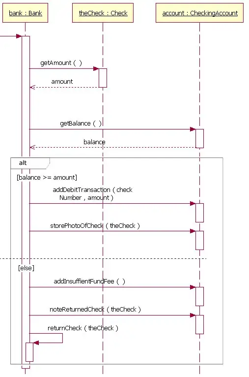

Just wondering if there is a good way to do this? Currently i'm performing the method calls as if they were happening prior to the conditional block, then comparing what would be the result in "[isDoable == true]" with isDoable being the result of the long chained method call. An example of the method call contained within the if would look something like this.
if(object.getObjectType().getPossibleAction().isDoable(action))...
I realise this is a bit abstract but any help would be greatly appreciated.

If that's a good idea or not depends on the detail level you want to show in your your diagram and what the reader expects. Also whether you do MDD or not.
Most UML Tools like Magic Draw or Enterprise Architect allow you to define an abstract (displayed) condition and to enter the actual condition in form of code snippets or pseudo code in some usual not visible properties.
I prefer the abstract style like [isDoable == true]. For me it's easier to read. If I need more details I have to look somewhere else (like the code snippet property)
Btw. You may should think about if it would not be a good idea to ask the object directly whether an action is doable rather than exposing the internal structure of objects via call chain. For example object.isDoable(action)
See Law of Demeter
See also IBM's UML Basics: Sequence Diagram
